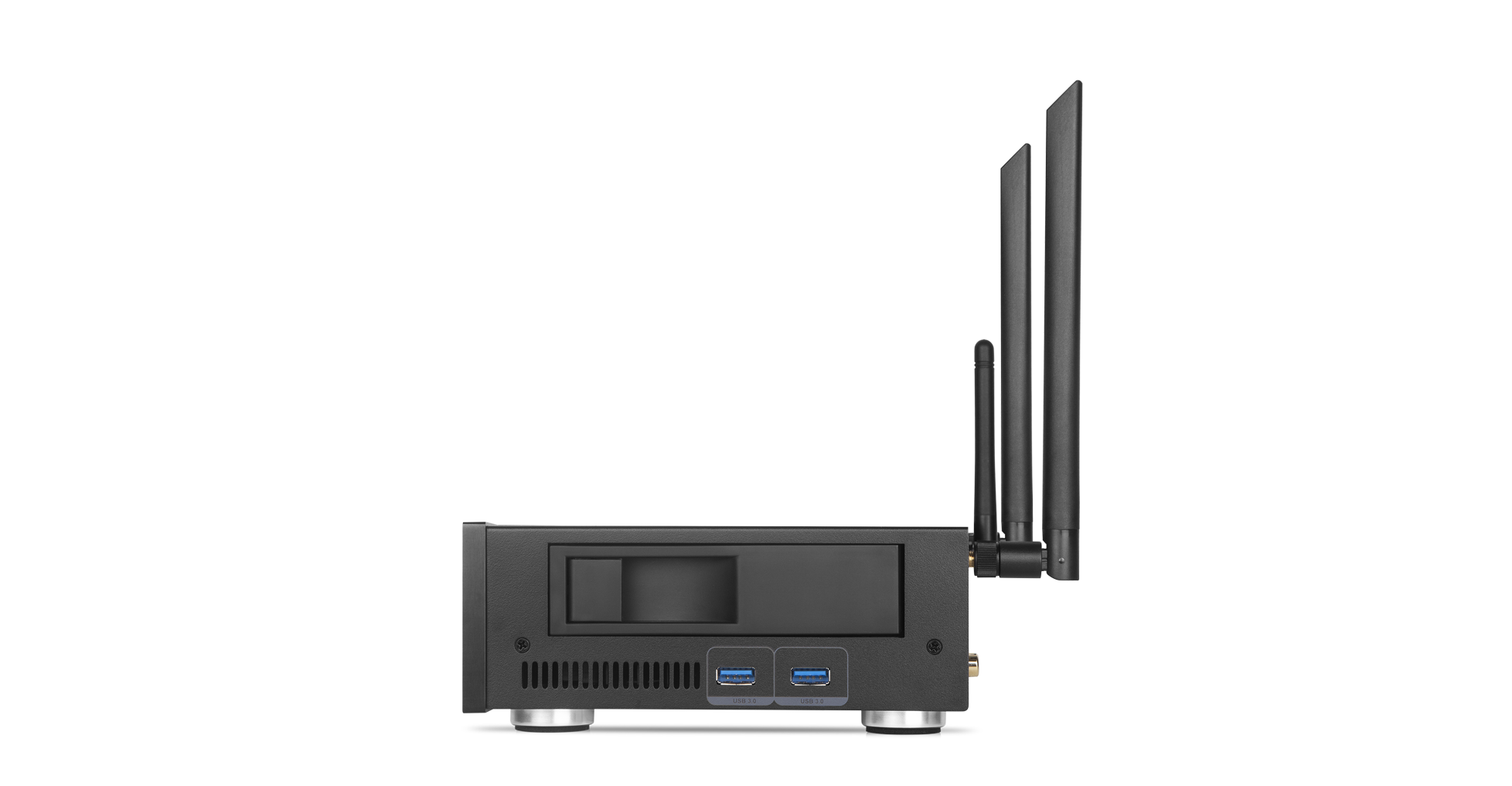

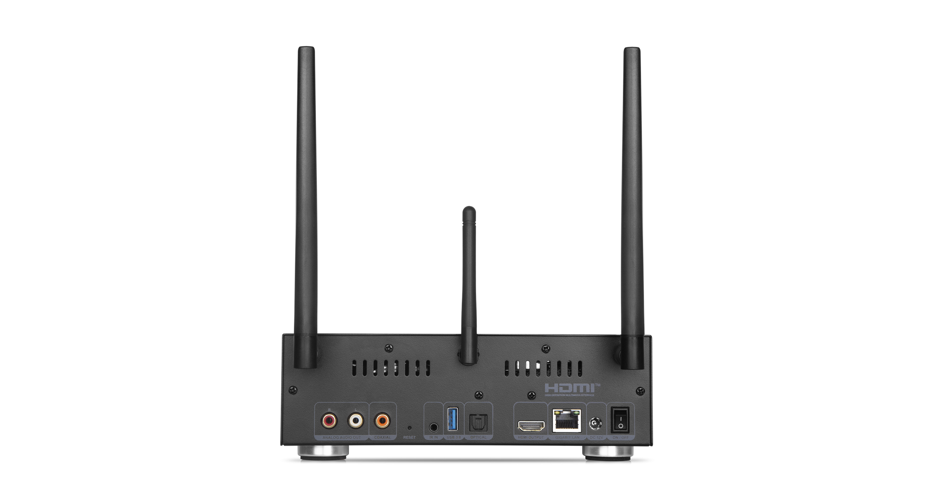

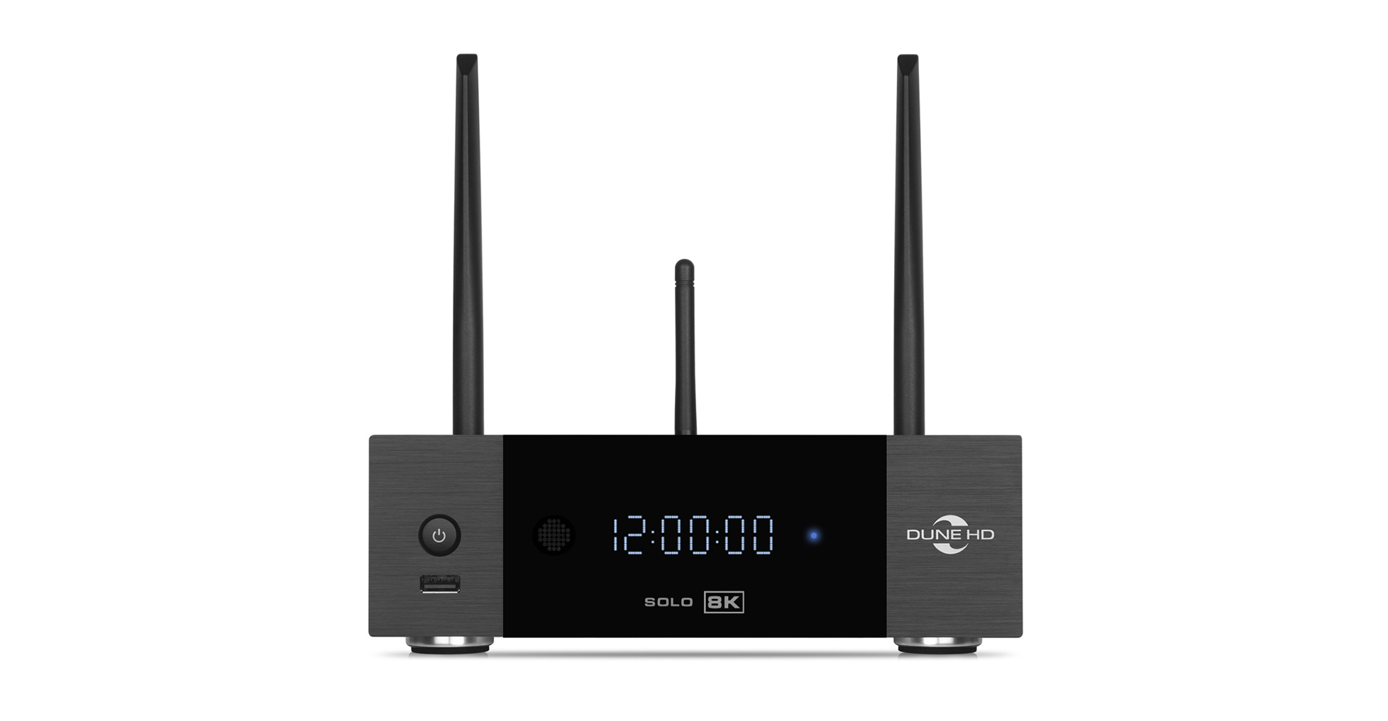

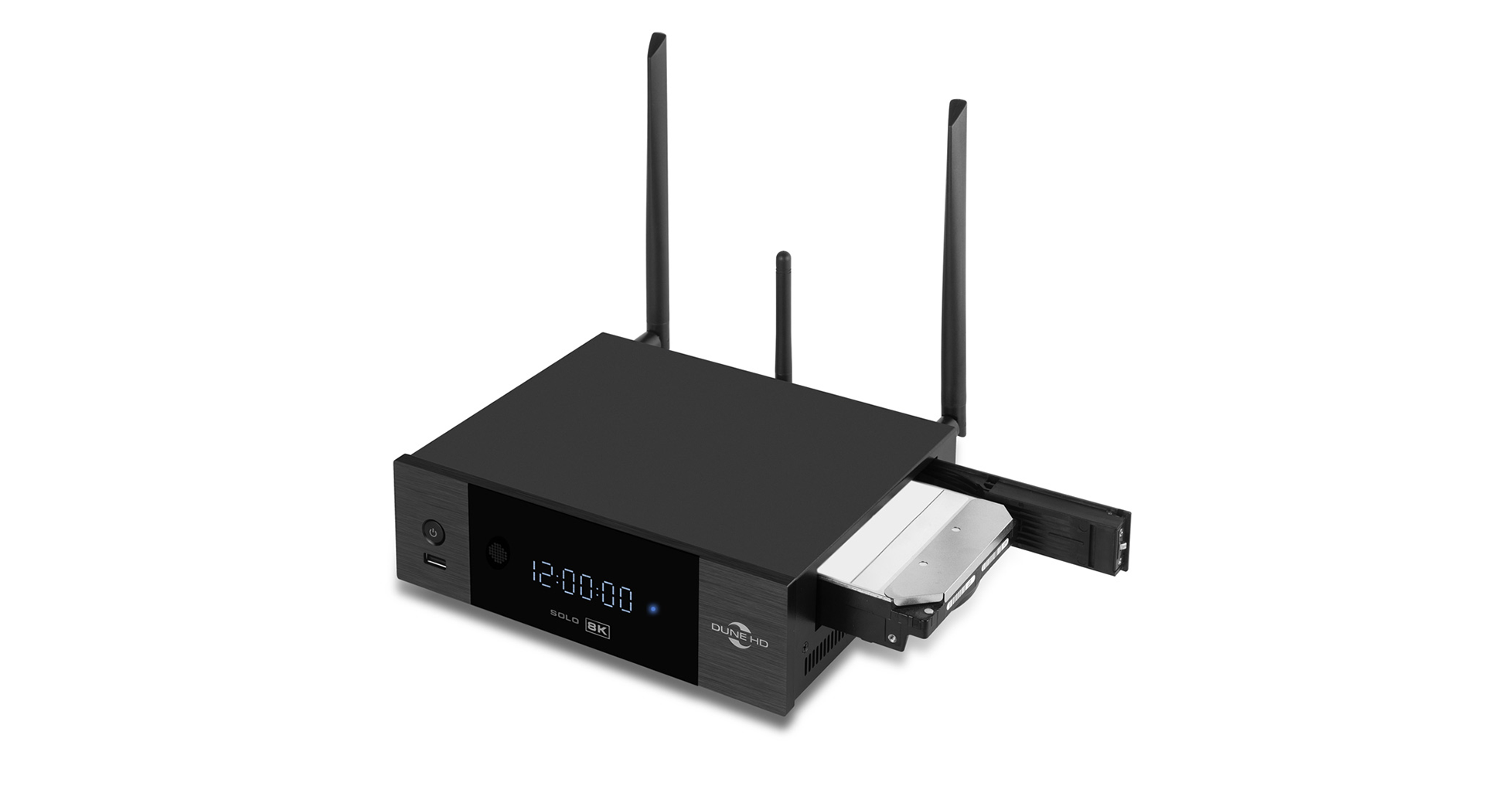

Фото

USB ports: 3x USB 3.0 host + 1x USB 2.0 host
Built-in HDD rack: 3.5" SATA HDD, up to 20 TB and more, hot swap
HDMI output: HDMI 2.1a up to 8Kp60 HDR / 4Kp60 Dolby Vision, experimental support for 120 Hz (up to 4Kp120)
Analog audio output: 2xRCA (stereo audio)
S/PDIF output: Optical S/PDIF, Coaxial S/PDIF
Front panel display: Multi-segment LED display HH:MM:SS
Front panel power button: Yes
IR receiver: Built-in IR receiver, supports Dune HD IR codes and Google IR codes
IR input port: For connecting external IR receiver (not included); 3.5mm minijack, T-R-S: 5V-iR-GND, L=14.5mm
Antennas: 2x external Wi-Fi antennas (detachable) + external BT antennas (non-detachable, because it is needed for Bluetooth remote)
